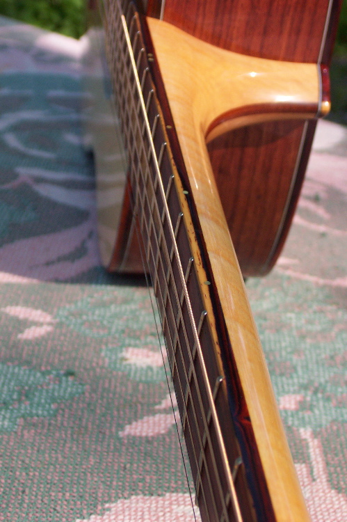

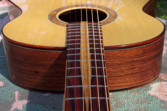

Hey Bob, I like to use sapwood... everywhere I can put it.
I sometimes reinforce the fingerboards by laminating a strip of mahogany under the board... I always bind them anyway so it doesn't show.
This one even has sapwood in the FB binding.
long

Bob Long I like that very much. Also by laminating a piece of mahogany to the bottom of the FB sounds like a good solution to me. Sure opens up a new world for fretboards.

Wow Bob, that fingerboard is stunning. The binding too. I love it.

That's a sharp fingerboard------Snick

I like the look of an inlayed fingerboard.
What about the wear of the fretboard? Would the sapwood area wear away under heavy use?
Philip
aka konacat
PostPosted: Tue Oct 30, 2007 10:21 am
I like this idea a lot. I think a thin strip of sapwood down the center would be very cool!. Also,Great guitar Bob Long!
Good question Philip.I wonder how it would wear over time.
